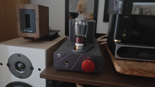

If you're into the tube sound, I can recommend the XDUOO TA-66, these cost about £250. I've replaced the original tubes on mine with ones from other manufacturers and this has cleaned up the sound further but at an extra cost. The generic tubes are good enough and excellent sound quality can be had.

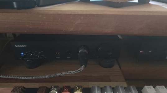

I'm also delighted with my SingXer SA-1 class A headphone amp, these provide RCA as well balanced XLR inputs and outputs. The SingXer also provides three types balanced inputs 6.3, 4.4 and XLR. The TA-66 has RCA inputs only. The SingXer I believe have now been discontinued and these can be had at a very reasonable price on eBay.

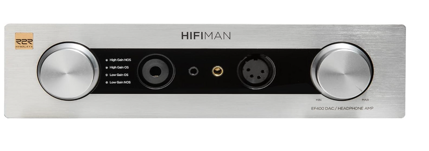

Also going cheap on eBay are the Hifiman EF400 and it comes with R2R DAC. Selling second hand for about £297, normally retails upwards of £500 new.

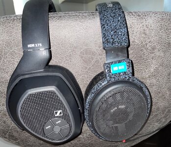

I have 2 diffrent Sennheisers HDR 175 that are wireless with a transmitter and HD600
always liked the build quality and sound.Tried a few diffrent brands a few months back that WHF reccomend was not impressed sent them back.Hopefully wont have to wait to long for the Amp to arrive .
