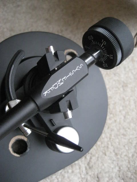

Without wishing to sound like an idiot - I have no idea! I have looked but it is obviously still the same original tonearm and cartridge but I don't know what they are.
No, not sounding like idiot. Some are hard to determine and many arms were fitted to this deck. Should be something on there in the way of markings that might give a clue.

Many Systemdeks were supplied with their own arm (marked 'Profile' in red or 'Systemdek' in white lettering). Some other popular choices were OEM RB250s / RB300s and Mission arms and Linn Basik LVXs.
