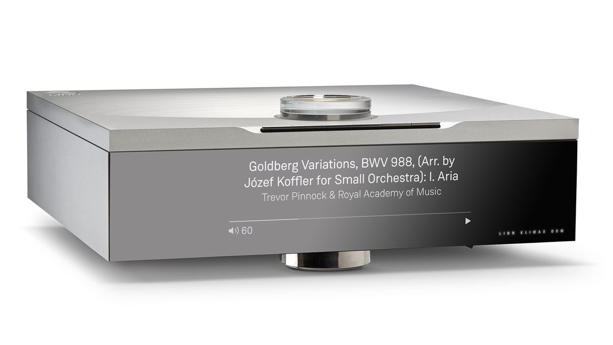

Always have been I feel. Nicely made but pricing has always been a bit in la-la land
Indeed. Very over optimistic, especially if the analogue inputs don't stack up, according to the WHFI review.
I knew this would happen 3 years ago, the likes of Creek's new amp is over 4k, these various heritage speakers are ludicrous, Linn, Harbeth stupid price hikes etc etc etc.
When people are using food banks just to survive....
Bleat over....
