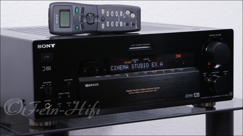

Things are getting exciting ordered Sony STR-DB930. Now we'll see what all the fuss is about. Should have it by Thursday 🙂

Talking of the Sony DB930 I'm positive I had one way back, in say 2001/2 just before my daughter came along, if it's the same model I'm thinking of... unique remote with screen. Loved it and it was the best thing I owned at the time by a country mile.
That's the one. A 110Wpc budget receiver flooded with Nichicon Gold caps like no high-end amp ever was. 15,000uF Nichicon main filter caps, thick speaker cables for the terminals, AKM DAC, Alps volume pot, discrete output trannies. A real oddity.
