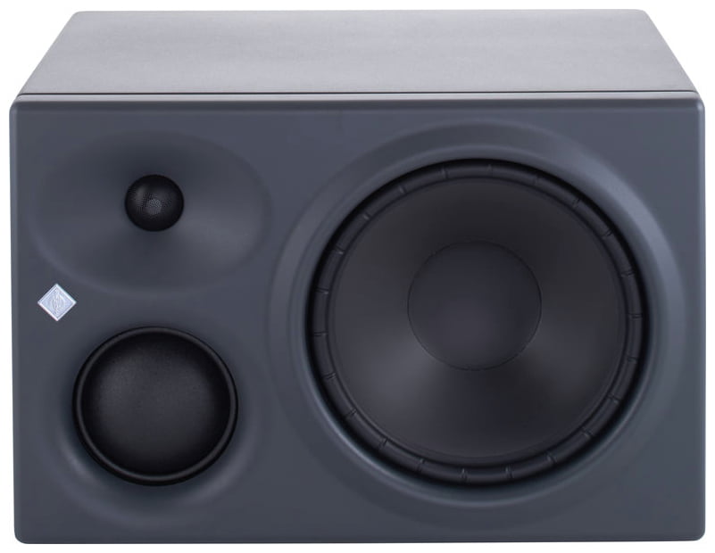

Right speaker
Left speaker
As others have mentioned, an offset tweeter is the usual reason.
I've seen it with a number of active monitors, but I also recall some Proac speakers.
spiny norman said:
gasolin said:
Right speaker
Left speaker
Still a matter of taste whether you prefer the sound with tweeters 'in' or 'out'
And one could put "normal" speakers upside down or on their side if one preferred.
