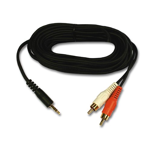

2) Connect your TV via headphone jack using jack to RCA cable.

2) I guess this means finding a lead with headphone jack on one end and red/white plugs on the other (excuse me if I'm being simple here).

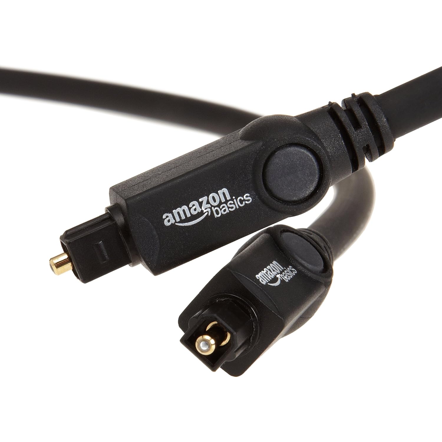

1) It's the Digital audio port next to HDMI 3. Use this cable.
Connect it to "Digital Optical In" in your Denon.
2) Yes, you're correct.
