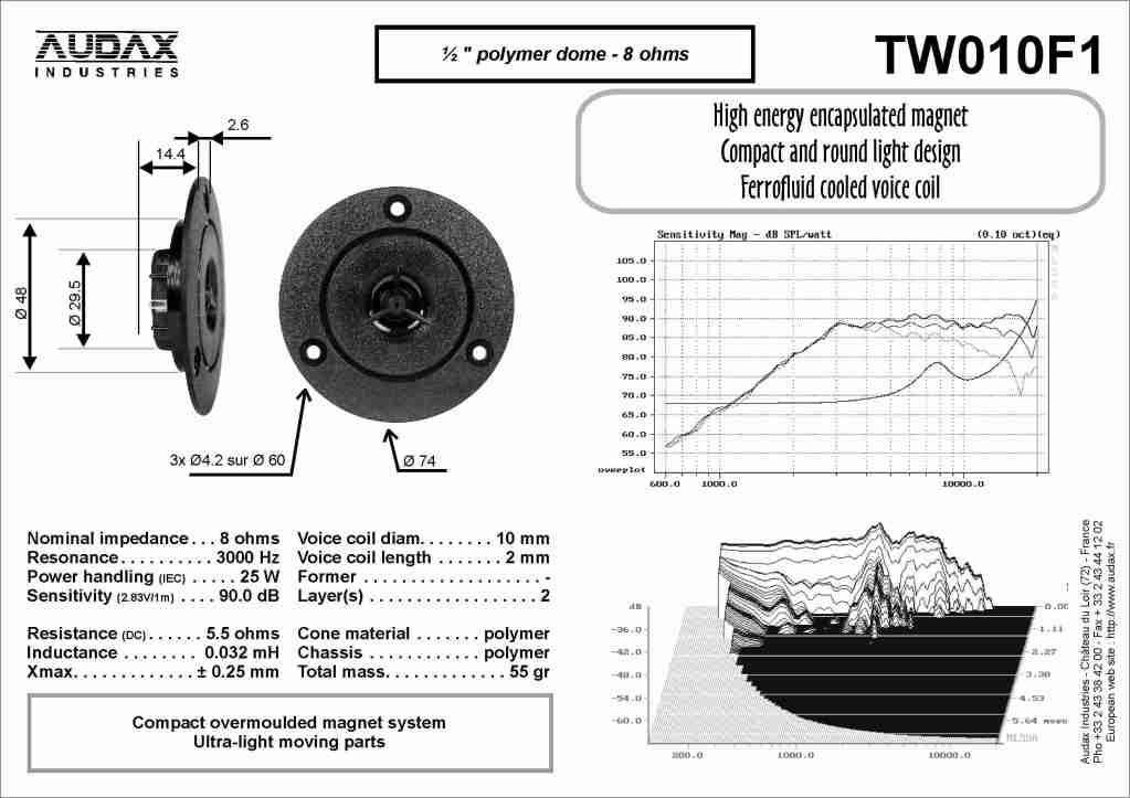

Bid successfully today on two 'new in box'/never used Audax TW010F1 tweeters for a total of £16.50 including P&P. Circular faceplates but that's no problem. Faceplates are interchangable with my JPW's rectangular (F3) ones because all TW010 tweeters fit into their respective faceplates with a twist/bayonet mount 🙂
I will report back when I have fitted brand new tweeters. (I know I only needed one but I thought two brand new ones would be better.)

'New' tweeters arrived this morning. Called local hi-fi shop to arrange fitting.
They fitted/soldered them this afternoon (only charged £10).
Been playing Bowie, Sly & The Family Stone, The Cure, XTC, a few 'Outnumbered' episodes from DVD and Radio 4 (currently The Archers) to get used to them a bit.
So far so excellent! Wasn't expecting much from them yet. (brand new/never used tweeters with a reputation for being harsh until broken in).

Chebby, were the old tweeters blown, or do they just degrade over time and need replacement?
One wasn't working when I took delivery. The other was fine.
The elderly gentleman I bought them from probably didn't even realise one had blown. (I didn't pursue the matter as replacements were easy and cheap to find.)
However I decided to buy two ('new/unused old stock' boxed) tweeters so they matched better.
I don't think such things degrade over time. Plenty of 10, 20, 30 year-old (and even older) speakers out there with original tweeters still working to oppose that notion.
The Audax TW010F1 tweeters were pretty ubiquitous and used by Wharfedale, Goodmans, Mordaunt Short, JPW (and many other brands) over many years.
You'll find speakers on ebay - much older than mine - with fully working, original, Audax tweeters on any day. (Even some suprisingly expensive models used them).
