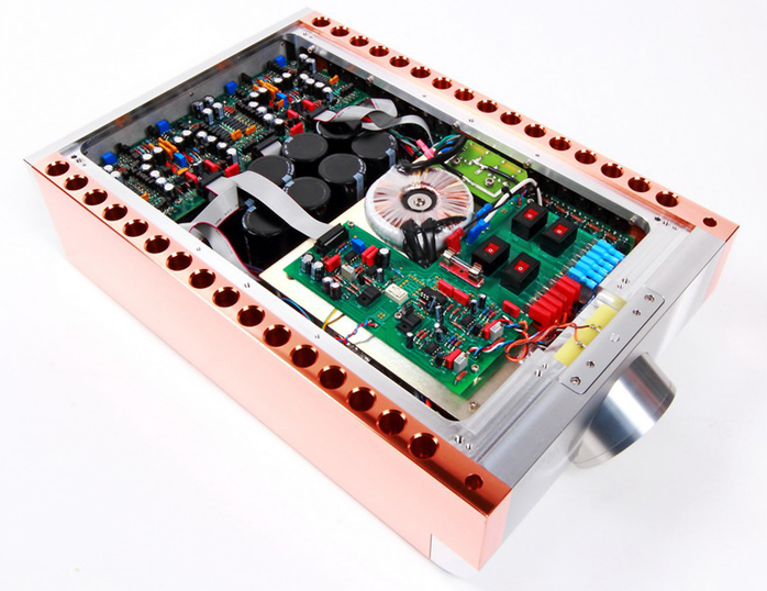

The D'Agostino amp looks alien submarine technology for interdimensional travel, but under the shell its still just an SS amp very similar to the CA. They both make small signal into big signal. However, they are similar like Citroen Saxo is a car and Ferrari F1 is a car.
