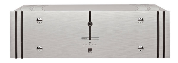

My setup was RME ADI2 & turntable> ATC CA2 with phono > ATC P1> ATC SCM11. The CA2 was fine but lifeless and a bit clinical. I replaced it with a (almost one third of the price) Croft 25 phono preamp and the result is the sort of sound I would guess you are looking for. If you don't need a turntable there is a Croft preamp without that is cheaper.
