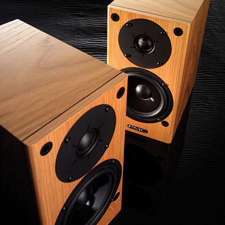

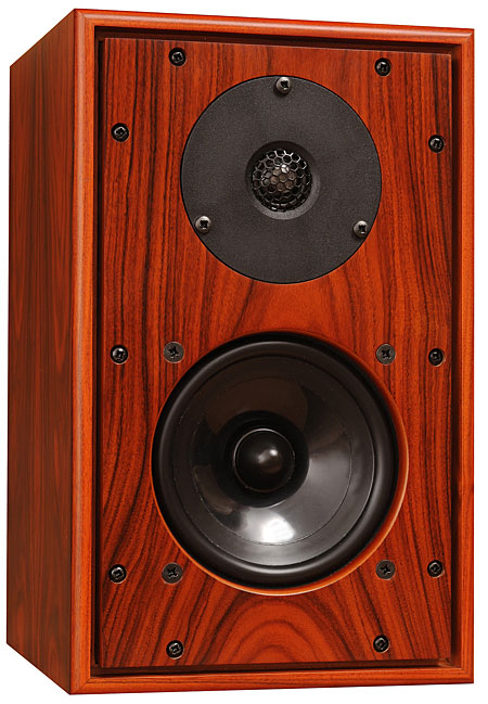

As the title suggests.
Currently more than happy with the little PMC’s in my lounge, (anything bigger just becomes unruly with bass due to placement issues, plus I’m not that much of a bass-head anyway). But the little Harbeth’s are popping up on my radar and receive high praise for their voicing. Noticed that the specs for each speaker are slightly different:
PMC: 50Hz-25kHz
Harbeth: 75Hz-20kHz
Would I really notice the -25Hz from the low end and the -5kHz from the top end of the Harbeths? Could the LF be reinforced somewhat with closer wall proximity placement? The wall proximity trick seems to work with the PMC’s as I tried an experiment on Friday and pulled them away from the wall on stands and they became very anaemic so went back onto wall brackets pretty quickly, (seems I got the placement right four years ago). Not interested in adding a sub.
Any advice would be greatly appreciated.

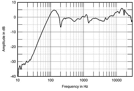

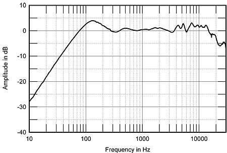

Nothing under 100-80hz and it will feel thin, not really feel like it can play deep bass, look at the difference at -10 db and at 30 hz (-25db and -13db)
You’ll find the DB1s a more exciting and lively sound compared to the Harbeths, it’s just comes down to your preference in your room. The PMCs will be an easier load too, but if you can drive the Harbeth’s well, you’ll find these a more neutral listen.
My main concern was they state easy to drive yet their own figures go against this.
