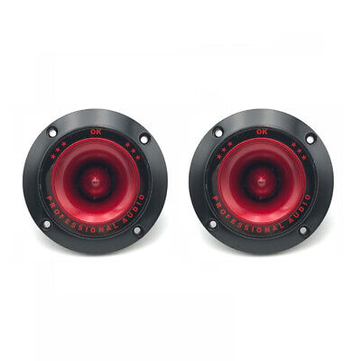

Have a look at these laughably cheap piezo tweeters - you can of course ignore the 'professional' label - they will not be high quality. However, they would bring back treble for you and, importantly, probably more readily withstand your volume levels. You can also forget about the series capacitor, as they wouldn't need it:
Depends whether their size would suit (you'd at least need extra screw and holes in different positions) but, not much to lose by going for them (y)
