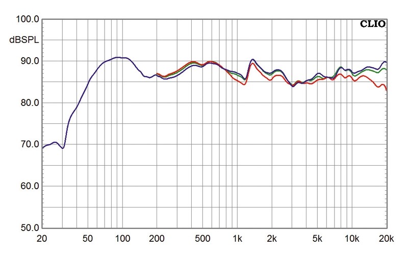

Am I right in thinking this is the frequency response of your speakers?
Source: http://www.hifitest.de/test/bildergalerie/lautsprecher_surround/audio_pro-avanto_50_hts_7423/3
Looks a bit one-notey in the bass region, possibly from excessive port stunts. Combined with their budget pricing this might explain the poor quality bass too. But that's just speculation. As is every reply so far. As we've not heard and seen your system in your room. Not with it compared to a reference system.
