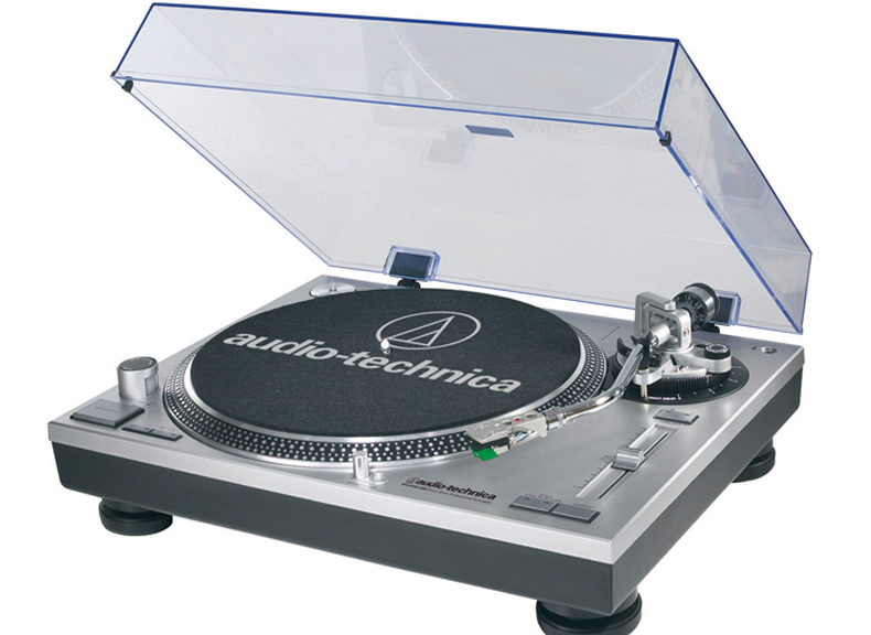

Thanks again, everyone, for your careful and considered answers. One last question: The Audio-Technica ATLP120XUSB has some features I'd like - digital out, 3 speeds, and the dread Bluetooth - but I'm not hearing or reading much about AT. Is there a problem with the product lines?
Theres no problem with the products at all ive had the lp120 for years now with no issues for the money its great value.Its a big step up from the Teac Its connected via RCA not BT.
No I don't think so. Audio-Technica are a well known Japanese brand.

Audio Technica is a solid choice, and that has a better arm, offering sufficient adjustment for a future change of cartridge should you wish.
