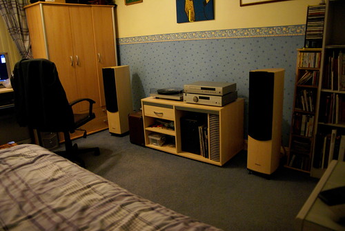

New placement of hi-fi AT LONG LAST!!!
admin_exported
Aug 10, 2019
2,556
5
BETTER? BEFORE...
AFTER...
Not only better but spring-cleaned too.
I'm not sure how welcome photos of forum-users' bedrooms are, mind you.

Oh SOO much better..
But doesn't the bureau door knock that beautiful speaker whenever you go for a pair of trousers?
A great improvement, but both speakers still much too close to objects to the side of them, and the left channel speaker in particular firmly in the boom zone with that nice resonant wardrobe next to it.
Is that a sub next to the unit on which the system is standing? If so, it'll probably resonate through the storage unit, and may cause feedback problems via the turntable.
Oh, and the CD player on top of the amp will cook very nicely, and may cause the amp to overheat - not good...
Well, you did ask...

That isn't a sub next to the hi-fi table thingy, it's an old Marshall guitar amp which I don't use anymore...it doesn't get used so it won't affect anything hopefully! The left speaker is, I know, still to close to the wardrobe - however it is an improvement over how close it was previously, so I think it will do for now...(if only I can persuede my parents to let me put the system downstairs)!
Those speakers are 190cm apart measured from the middle of them (ie the F of Wharfedale) and my seating position is around 230cm away. Does this sound about right? I have the speakers toed in around 2 degrees which using a bit of trigonometry means I should be seated WAY futher back to get the correct stereo effect...hmmm....any suggestions?
Try toeing them in so the speaker axes cross just in front of your listening position. It may look a bit extreme, but it'll give you excellent stereo imaging

[quote user="Andrew Everard"]
[/quote]
Okay! I'll give it a shot and reveal the results in two hours time! Got Nick Cave album today! Woohoo! What happened to the Bad Seeds anybody?
[/quote]
Just for interest, (and to semi-hijack...) what should you do if the opposite is true i.e. you can't put the speakers any further apart, but you have to sit further away than recommended...just leave them face-on?

I'm no expert, but I doubt conventional speakers are designed to be toed out, thus I would think face-on is best. All speakers today have quite a wide sound dispersion so I should think straight is right. Perhaps even give it a couple of degrees inwards!
Listening to my system now, I have got by far superior imaging but a much more sibillant treble (which is hurting my ears a little at -18db or more) and I could also do with a bit more thump in the bass rather than the droning it is giving (most likely because it is too close to the wardrobe, wall etc) would upgrading to a CD192 improve this or perhaps give a more dynamic sound by going for a Naim Nait 5 CD player.
[/quote]
I dread to think of what you'd make of my speaker placement as I have less room for the speakers which have to go in the corners
Thoughts of "Boom! Shake the room" by Jazzy Jeff and the fresh prince, spring to mind! ; )
One of mine is a bit too close to a wall for comfort... I've found if I leave the bamboo blinds I have on the window there down the negative effect of the wall is considerably lowered. But more importantly I've found toe-in to almost completely rectify the wall-effect. I've got my boxes just shy of crossing paths at my listening position.

[quote user="raypalmer"]One of mine is a bit too close to a wall for comfort... I've found if I leave the bamboo blinds I have on the window there down the negative effect of the wall is considerably lowered. But more importantly I've found toe-in to almost completely rectify the wall-effect. I've got my boxes just shy of crossing paths at my listening position.[/quote]
