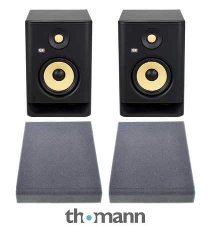

I don't think you have the correct tech or set up for your situation. If the speakers are only 20 inches apart you are never going to get an acceptable sound with traditional stand mount passives. I'd be looking at selling the amp as well and getting a small set of desktop actives such as Ruark MR1 MK2 which are designed to work far closer together or a set of mini monitors which are again designed to focus the sound more when not being placed to far apart. I'd also invest in some isolation below each speaker as they will be having a negative affect on each other being that close together on the same surface. Other option is a lager smart speaker.

I do think @Tonestar1 makes a very good suggestion however. Actives such as the KRKs are designed to be used in recording set-ups where space is often at a premium and might just offer you the solution you need.
