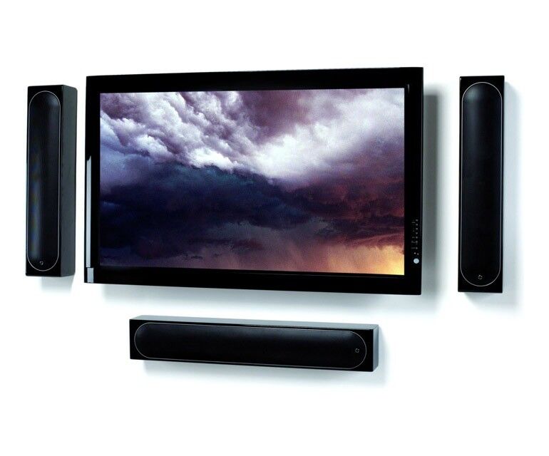

Hi there, may we discuss also a solution with a TV? in this case is not possibile to place the speaker behind the screen, so should i opt for a stand speaker. What is the best solution I can get in this case?
What type of speakers will you be looking for? Floor standing speakers or wall speakers?
I had Monitor Audio Radius speakers in my previous house. You setup would look like this with them:
