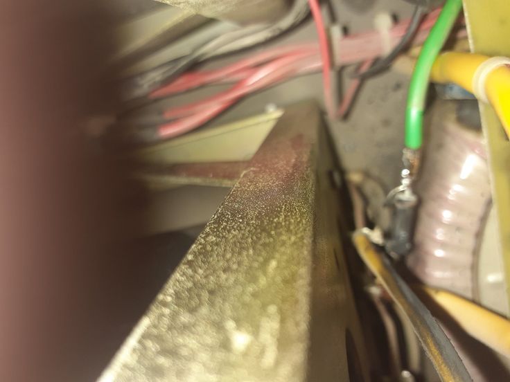

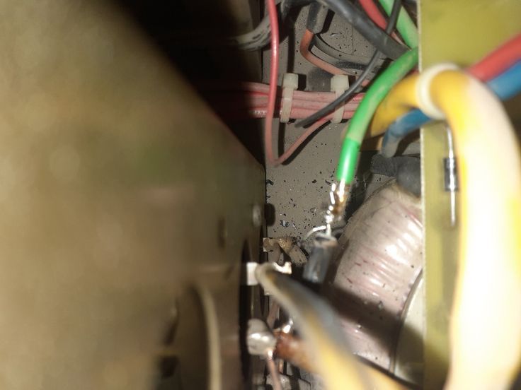

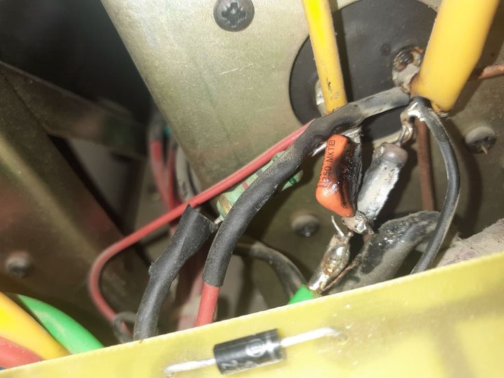

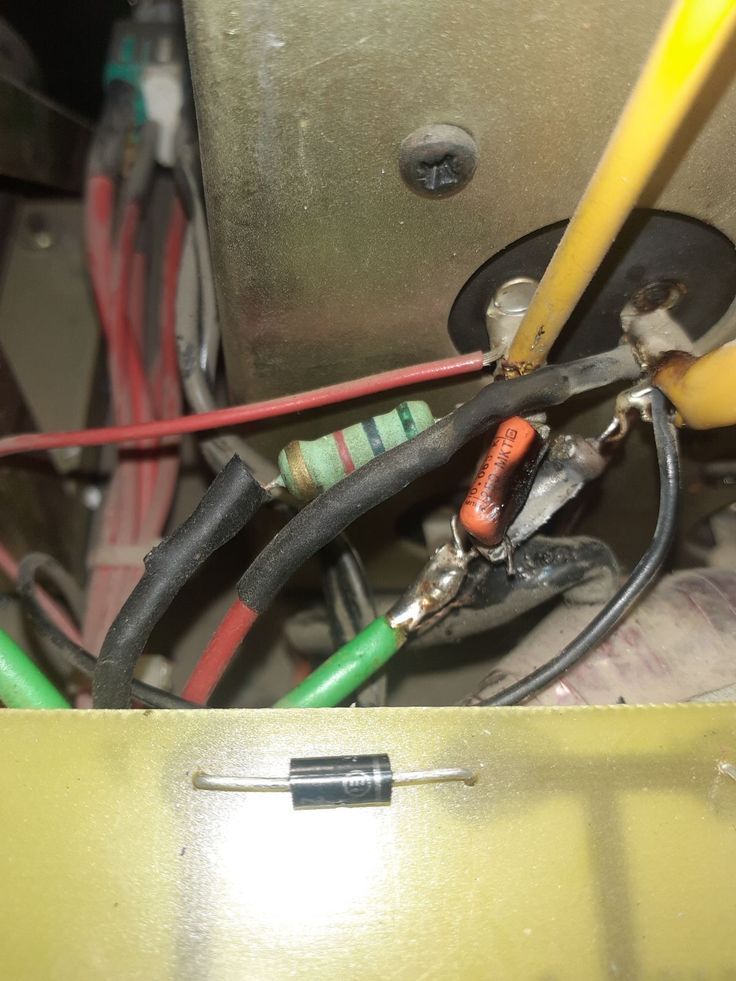

This is an image from the web and the problem area is circled. This is where the capacitor and resistor are located. The value of the capacitor can be seen and no problem, but the resistor is so burnt that the value cannot be read. There are two resistances. One on each side. This connects the amplifier ground to the mains ground.
The component in your circle looks to me like a bridge rectifier (which has 4 contacts), not a resistor.
See if your cousin agrees.
I'm a bit concerned about other (more sensitive) electronic products in your home.
Even when not visibly damaged and still working, their lives can be shortened).
