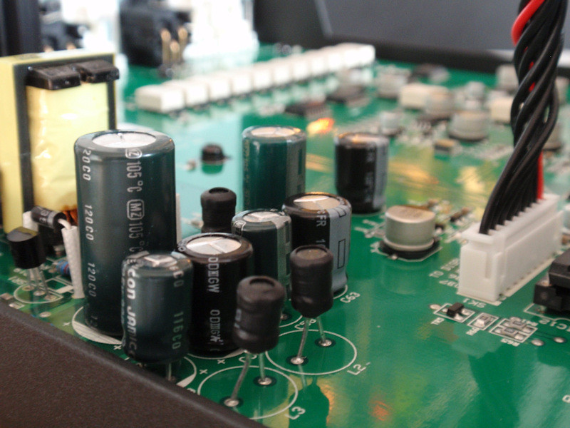

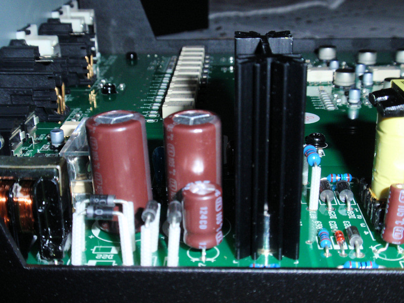

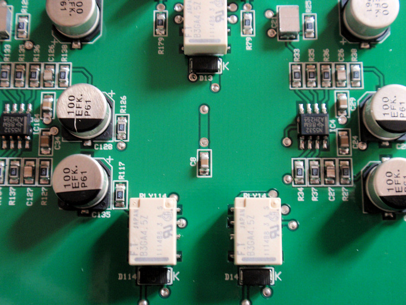

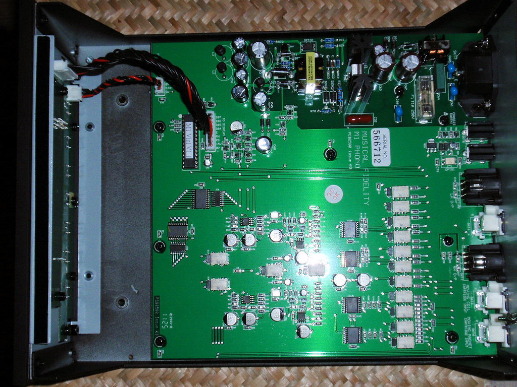

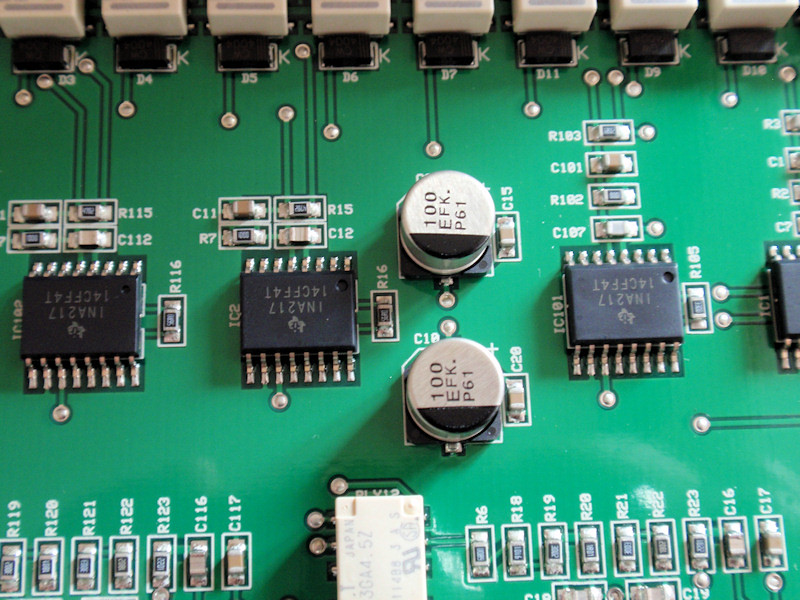

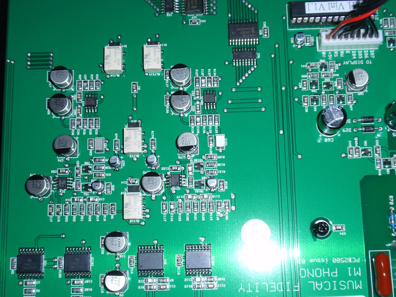

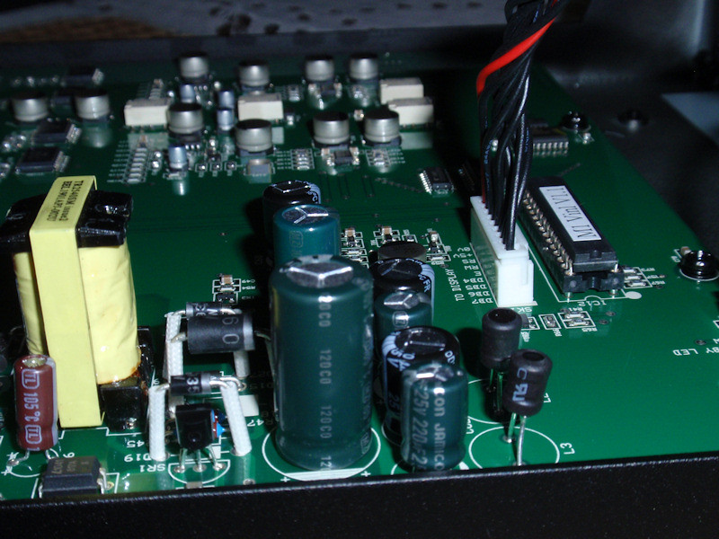

I decided to share some MF vinl nude pictures ... there are NE5532, LM318N and Panasonic FK capacitors on board...and some Jamicon's caps in PS..
I wonder what opininions you might have on built quality and used components...? :quest:

The naked pictures......look very green.... SOrry TomTom....internal parts are way beyond my expertise nor interest.....i rather enjoy the music produced by the component rather than pondering on the internals....too much work...definitely not something I would want to venture into after long hours at work...
