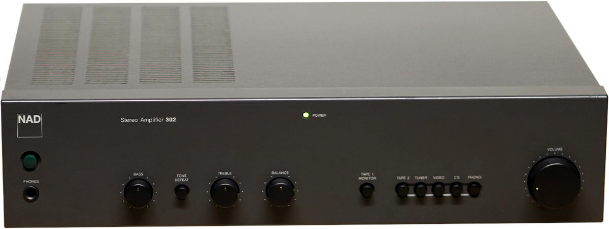

Yes it can be done, as long as you let us know exactly what amp it is. At a guess it will have a tape out or a headphone socket and you'll have to use that. The Avantree needs a digital optical input, which you probably don't have.
We need more details before you buy anything.
daveoz
Oct 31, 2020
Thanks - yes it's a NAD 302 which doesn't have any optical out...
There's a headphone jack, and 2x tape out phono rca sockets.
