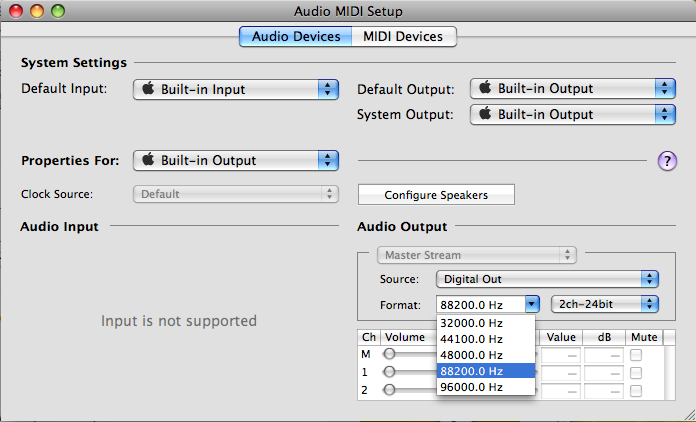

Hi - I thought I'd try out some high-res music so i downloaded a 24bit 96khz FLAC sampler. I've tried playing this on my MacBook Pro via the optical out to my DAC Magic and the sample rate indicator on the DAC indicates 44.1khz. I've tried playing the file back with both VLC and Songbird and it's the same. I've looked at the settings in both applications and the sound settings on the Mac and I can't find anything pertaining to the sample rate of the spdif output.

Something to do with 'Audio MIDI Setup' in your Utilities folder, but can't immediately spot what (this is a weird Macbook, might need to look on the other one...)
Here:
Yes, thankyou it worked perfectly! Just one other thing, do you know if it's possible to set a mode for the bit length and the sample rate so that they will just automatically be whatever is native to the material being replayed? When I have a decent number of high-res files it will be a bit of a pain having to change those settings everytime I want to switch between 16/44 and 24/96 or whatever.
