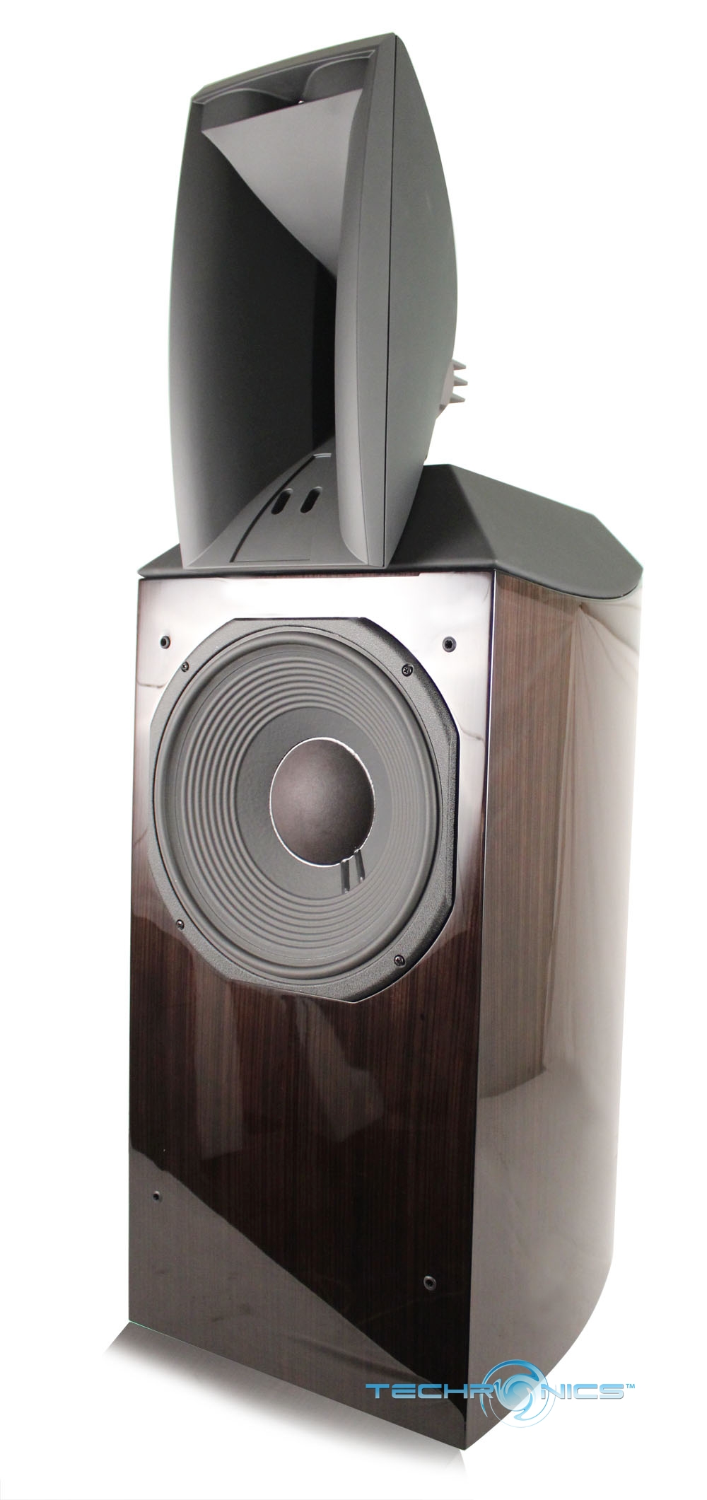

Both speakers need more space than I have, by a fair margin.
Big (ish) JBLs work best at a distance, for me anyway. Never met a floorstanding Mission I didnt hate.
