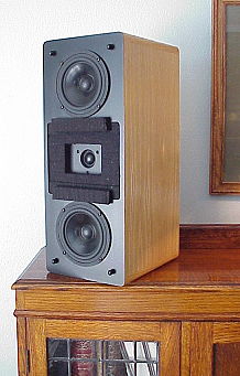

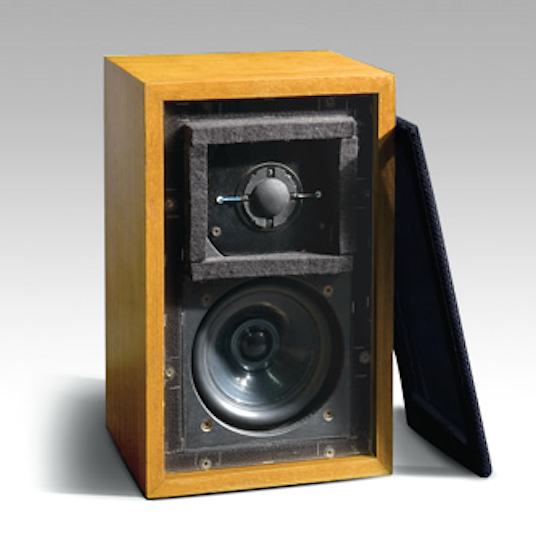

Something from the old masters is dealing with diffractions (sound waves bouncing off edges). KEF in its Blades sorts them out by curving the front baffle.
But what can a poor boy do? In the oldee days they used felt, neopren and sponges, as many of you would remember.
For some reason these have fallen out of fashion (more priority for furniture than fidelity I guess). So when a cabinet produces diffractions, the midrange sounds grainy and instead of putting these fugly felts and sponges, today manufacturers just use nothing, but drop the midrange so the grain isn't noticable. When you turn up the midrange on the B&W CM1 it sounds a bit nasty, so you turn it back down to factory settings, the wet blanket effect. Notice the cabinet has no solution for diffractions.
My poor man's solution for the Sony's, although they don't show much grain and sybilants untill turned really really loud. Just cut out some foam and stick it on with doublesided tape.
Makes me wonder, how much of today's speaker design is compromised to sell more in compliance as furniture.
