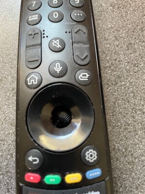

Any body else had any issues the roller just popped in to the remote .I have a extended warranty and they have agreed to replace it at just over a year old not impressed .

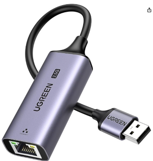

As we're discussing LG remotes; I thought it was worth me sharing; there is an ethernet USB add on you can try. You may not be aware most LG TV built in ethernet is compatible upwards of 10-100mb, so if you're watching 4K television from your streaming provider like Netflix it's likely to be heavily compressed, thus the picture quality is nowhere near it's absolute best.
If your internet bandwidth is already low, you can ignore my post but if data stream is >100mb, please see my comments below 🙂
On Virgin Media I'm subscribed 1.3 gb broadband but most of the time, I'm averaging between 900mb and 1.00 gb.
If you're receiving high bandwidth broadband it is worthwhile getting yourself
Ethernet Adapter, 2.5Gbps High-Speed Network Adapter for Gaming and 4K content, USB 3.2 Gen 1 RJ45 Gigabit LAN Adaptor.
Before adding this device to my LG C4 USB socket, I was get a paltry 19-25mb and the picture wasn't that great. I'm now getting in excess of 310mb and 4K is beautiful, no compression.
Check out the Amazon link below.
https://amzn.eu/d/6xPzHj9
I have the ASUS version, I've tried it fully compatible with LG C4.
https://amzn.eu/d/4sloKfb

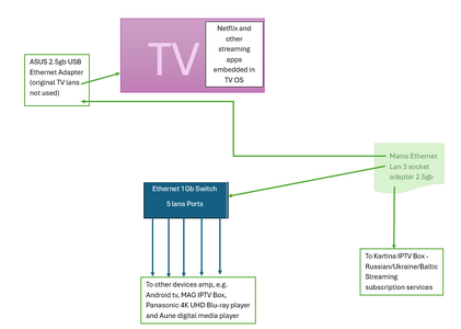

How are you running Netflix.
Jason are you talking about the internet tv speed maybe be a dumb question ? I have just connected my 5G router to the ethernet for the first time im getting 100MBps
Netflix app is on TV.
The Virgin Media router is upstairs, it feeds into mains ethernet lans (2.5gb Magic Devolo mk2), this is received by another Magic Devolo mk2 (3 port) in the lounge.
the output from the Magic Devolo feeds directly to ASUS 2.5 ethernet USB adapter, which is plug into the TV, thus allowing Netflix and other streaming apps to be connected.
The second and third feed from Magic Devolo goes to the router switch box, this connects to all the other devices and the other direct feed is for Kartina Russian TV service.
I hope this explains 🙂

I would recommend everyone not waste their money on a 2.5GbE adapter for their TV.
The 100Mbps NICs in TVs are not the bottleneck Jason is making them out to be.
Netflix averages around 15 Mbps and peaks around 20 Mbps for UHD/HDR content. Amazon Prime is similar.
Apple used to recommend 25 Mbps for 4K/HDR purchases etc, not sure about ATV+.
The BBC recommend similar for streaming in UHD/HDR.
HD content on PSB VOD services peaks around 5 Mbps.
I also doubt many TVs have the necessary processing (or even USB version) to handle 2.5 GbE networking....

On Monday i contacted Domestic & General who the extended warranty was with that came with the TV from SSV.After a few minutes D&G said a company called Equinox Maintenance would be in touch 10 mins later it another Email from them asking for a picture of the remote and TV Model i replied.
10 mins later i get another Email from D&G saying the repair had been approved.
Tuesday I get another Email from D&G saying the part had been ordered .
Wednesday morning ( today ) i get a text from DHL with a delivery time slot for the parcel from a company called JST Electronics mmm never heard of the so i looked up the website interesting they do repairs sales TVS and lot more worth a look.
The Magic is back and alive i missed it has it works well with everything.
So there you go 3 different companies for 1 remote with great service and speed .
Glad i have the extended warranty the remote is £40.00 on the JST website .
I can relax now 😇

Perfect outcome, almost Magic! 😁
