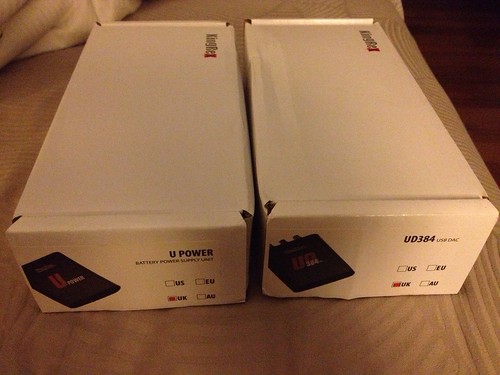

Hi all, I was recently contacted by Kingrex (www.kingrex.net) from Taiwan to have a go with their newest product; a 2 in 1 32 bit/ 384 kHz USB DAC and a SPDIF converter for you to hook up to external DAC. Received the items last night and it also came with a mathcing U Power which is their battery based power supply unit. The DAC also came with its own PSU but this power is for a more stable power supply. Watch this space for a review.

When I was first contacted by Kingrex via email, I thought it was a friend of mine playing a prank on me. But when I looked at their website, I decided to reply their email and 3 weeks later, I received the UD384 USB DAC and its matching U Power battery based PSU.

The UD384 comes with a 3 pins UK ‘walmart’ power supply, A-B USB Cable and a thumbdrive which has the required driver for Windows, plus some music samples (well at least for the unit I received). Readers may be familiar with my particular dislike against those 7.5V power supply plugs but thats just me. The yellow power indicator LED is also very soft to the eyes.
The U Power comes with the same 3 pin UK power supply to recharge the battery, another power supply cable to connect from U Power to the UD 384 and a product manual. It has a switch to choose between supplying power to the UD 384 DAC or to recharge the battery. The green power indicator LED is also very soft to the eyes.
