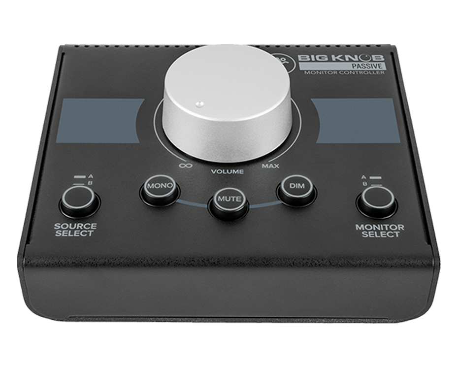

Also, the Mackie Big Knob Studio is within your budget and it would give you a ton of flexibility ('magic' indeed).
You could listen to your turntable and play through the guitar processor at the same time and even record it all into a DAW on your computer.
You can even plug in 2 pairs of headphones and add a second set of monitors at some point in the future.
Yes, the output from the 'mani' would be sufficient as it has line level outs. As the Mackie is a prosumer product, it has the option of selecting both consumer and pro line level input levels (+4db / -10db) and has bal/unbal inputs.
