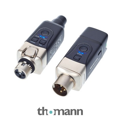

You might have a look at the pro-world, lots of wireless transceivers e.g.
