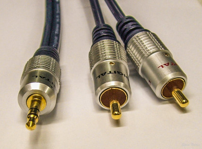

I see where Gray is going but with your current equipment you don't need active speakers so I would urge you to sell them on.
I think you need a cable like this from audio out on the cdp ,twin phono to stereo minijack, to your speakers

No, you could easily use the Denon CDP into the 'AUX' input of your Audio Pro speakers, by using this type of lead:
(Better still, use an optical lead, as suggested by jj bomber above).
But as Al said, your Yamaha would then effectively be redundant.
Your Audio Pro are officially a pair of powered speakers, but you're right to say that one of them is effectively a passive speaker.
It would actually be a fairly easy job for someone to modify the other one to become another passive, which would allow you to connect them to the speaker outputs of your Yamaha amp, so avoiding the need to sell anything.
It's also easy enough to just use the above RCA to 3.5mm lead to connect from the record output of the Yamaha to the Aux input of the Audio Pro. The volume out of the Yamaha would be fixed (so controlled on the Audio Pro), but you'd be able to use the Yamaha as a preamp for a turntable if you've got one.
