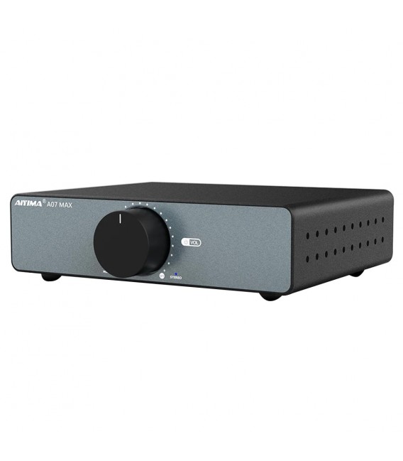

That is because they are cheap speakers £120 for amp,controls,cable,cabinet,3 units + a remote
If you wanna have cheap speakers that sound good go for edifier or a small class d amp and a pair of miccas
