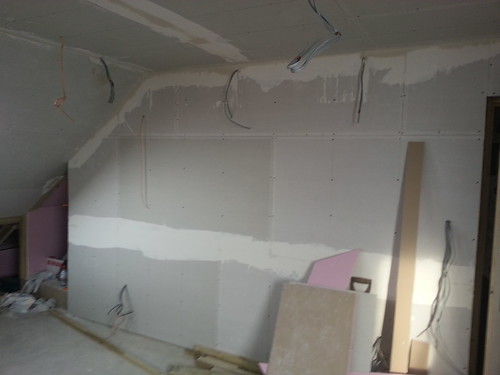

Second Layer of EcoTherm going in before double layer of plaster board - no mercy on the sound proofing 🙂

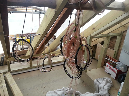

Two new pictures. At the stage now where the wiring is done, now it needs to be closed up!
Pictures below showing 16 speaker configuration (for dolby atmos), cables routed and tied at the back. Second picture shows first layer of EcoTherm

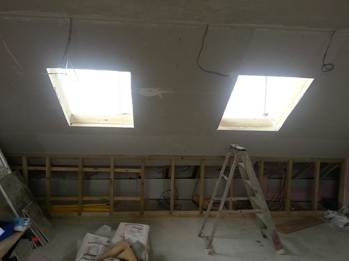

Getting there. The plaster boards for the ceiling at done. Now the second partition is going up to create the room within a room.

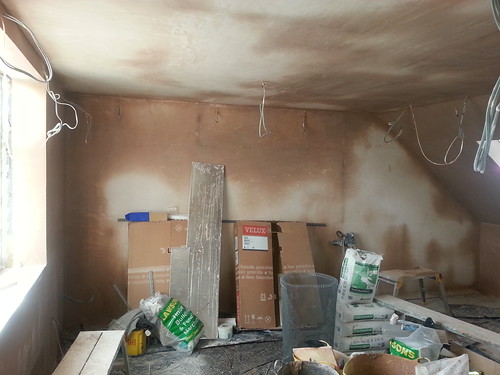

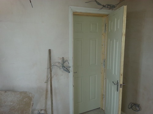

Room is now ready fr plastering.

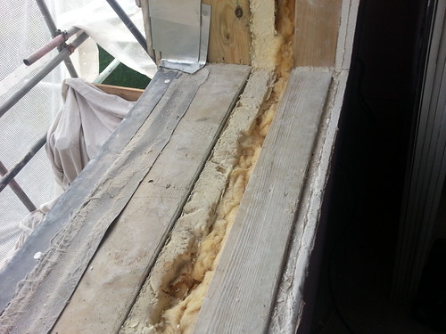

I have taken three pictures, one picture to show the depth of the wall and the soundproofing that has gone in. The wall depth stands at just over a foot deep all the way around. Room should be completed within 2 weeks 🙂
1ft deep wall, combination of Rock Wool, Ecotherm, stud wall and double plaster board
Slope side
Wall side
More pictures..... Room is almost ready for paint. Plaster is drying off nicely. Now for the skirting board with further acoustic foam to stop vibrations travelling
Pictures showing Skirting board with acoustic foam to stop vibrations and also a picture showing you the room within a room for sound proofing.
Skirting Board with acoustic foam underneath, this will connenct with the acoustic underlay for the carpet.
Picture below showing room within a room.

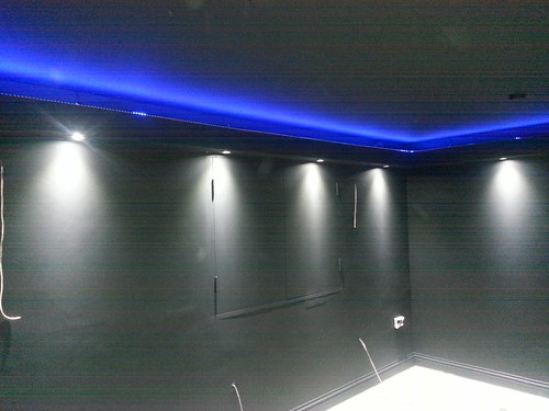

Hey Rich,
Very well actually, the room is painted, the electrics are done and all thats left is the carpet and equipment install. I have pictures which I will upload now, its very difficult taking photo's of a black room, but I have them 🙂
