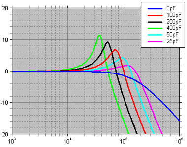

2M Recommended load capacitance
150 – 300 pF
OM Recommended load capacitance
200 – 500 pF
Incorrect loading Pf will affect the Sound

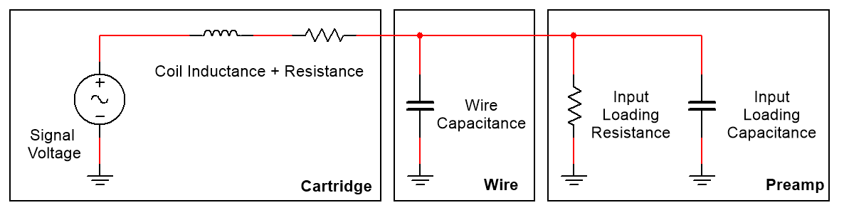

Phono cartridge is a minature electrical generator and correct loading the the phono stage can have big changes to sound
The cartridge + cable + preamp input form a resonant LC circuit (inductance of the cartridge + total load capacitance).
150-500pf Total PF
If phono stage is fixed PF Loading plugs of different values can be used
Too much capacitance will boost the upper treble then causes a sharp roll-off
️ Sound becomes bright, edgy, spitty, then very dull above the resonance point 18-22kz
️ can also cause very big Peaks around 10–15 kHz
Too little capacitance will reduce treble energy
️ Sound becomes soft, muted, lacking detail
MI moving iron cartridges Pf has very little affect Grado , Soundsmith , Nagaoka
