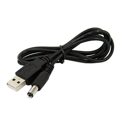

High odds the problem is in the DC wallwort. Since it's 5V you can try using one of these cable converters and feed it from a different wallwort, or from a laptop, phone, battery bank.
