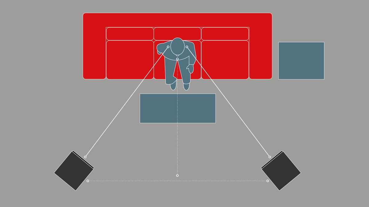

In a previous comment, I suggested taking a little time to get the positioning of the speakers right. I didn't think to ask if you had stands. Getting a sturdy pair of stands and getting the speakers the right distance apart and away from the wall will make a massive difference. Bi-wiring them will make such a tiny difference you may not even notice it.
Here is a simple guide to positioning:
A second hand pair of stands should be relatively inexpensive. See this one as an example:
