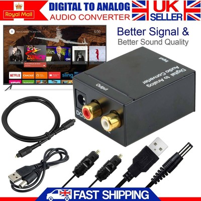

One of these would get your TV sound into your old Nad amp Billybodger.
(Via a twin RCA lead, that you've probably already got):
It's USB powered so from a socket on the TV itself or a separate 5v supply.
Before making the connections, go into the TVs audio menu and ensure that its digital output is set to PCM.
