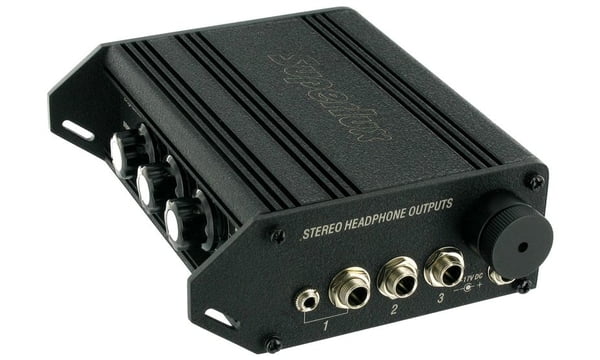

when I met Andrew last time I did have £85 Superlux HA3D with me ( copy of £600 Sound Devices amp). this is a headphone amp, in fact 3 headphone amps in one capable of 15V output able to drive 600 Ohms phones with easy and plenty of headroom, in robust aluminium housing, battery or mains powered.. of course we did compare this against benchmark, same song, same phones.. benchmark was receiving lossless from macbook and superlux AAC from iPhone.. of course we couldn't tell the difference between the two.. we'll test more in depth next time.
