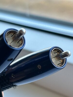

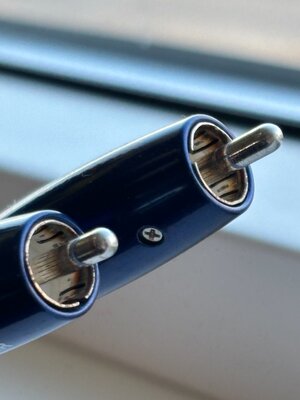

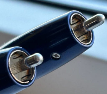

Hey everyone,
I recently got hold of a pair of Audioquest Water RCA cables with DBS, and I’ve noticed what appears to be oxidation or discoloration on the connectors. I’m unsure whether this is actual oxidation or just a natural aging effect of the materials.
To the best of my knowledge:
  • The cables have been kept in a stable environment, with no extreme humidity or exposure to harsh conditions.
  • Sound quality remains unaffected, but I’m curious whether this could lead to degradation over time.
Has anyone else experienced this with these, or other, Audioquest cables? Could this be damage, or is it simply a cosmetic change over time?
Thanks in advance for your insights!
- KL

Worth watching the Audioholics video on Youtube about the Audioquest Thunderbird Zero speaker cable which also has DBS.
By the way - the connectors appear to be silver or silver plated. Silver tarnishes naturally. Silver Oxide does conduct electricity, though.
Reactions: Dave_
Thank you for replying. Based on your knowledge, does the cables seem to be damaged/worn or is this a natural occurrence? I've never owned silver plated cables before, so it's all new to me.
Just the fact that I've never owned silver plated interconnects before, so this "discoloring" seemed a bit off to my eyes.
Thanks for all the answers! I reached out to AQ after reading through your posts. AQ has addressed this issue before with some of their high end cables. It's apparently harmless and can be removed with care. Thanks!
It has never struck me as sensible to plate plug and socket contacts with silver, precisely because, as stated above, it does oxidize. Rhodium is much better because it is very corrosion resistant and, gold is best because it is chemically inert. If a cable needs to be disconnected and reconnected often, rhodium has the additional advantage of being much harder, so more wear resistant.
Reactions: Gray and Al ears

Probably my eyes, the brown hue around the edges appears to be the result of intense heating from soldering. @Gray would know! 🙂
Probably my eyes, the brown hue around the edges appears to be the result from intense heating from soldering. @Gray would know! 🙂
The soldering heat should have been well away from those parts.
Looks like part of the general contamination.
True, silver polish would have the pins sparkling again - though not quite so easy to clean up the screening points.
No doubt a fair bit of the original cost was for the plugs, but I'd be tempted to fit new, decent gold ones.
