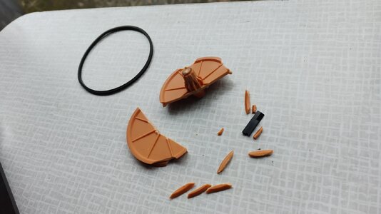

That's what to do first.
It has been the cause of eject problems on Philips mechanisms for some of us.
This was mine:
But in those cases you still hear the eject motor trying - you heard nothing.
