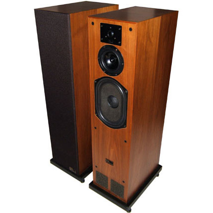

I recently purchased a pair of TDL RTL2 speakers and only now been able to use my Audiolab 8000c 8000p with decent ish speakers. I have noticed since the last time I head my audiolab (not with the TDL's) that I have to turn the treble all the way up to get a decent level in the High Frequency pressing the Tone Bypass just makes it sound like there's carpet over the speakers (ok not that bad but you get the just dull and no HF). I have changed all the cabling to Van Damme Blue Series Studio Grade aswell as the interconnects, changed the CD Player to a NAD 514 soooo.... What is my next move. I would be gutted if the Audiolab gear was up the spout since it will cost £200 to get it serviced which is money I cant afford to flutter away.
Any help guidance or experience is valued. :)
Now let me think. If these are the bigguns, you've got KEF drivers in them. Oval bass unit ( B139 ) a mid and tweeter.
I've got the mids ( B110 SP1003 ) and tweeters (T27 ). Call me on 01562 865788 if the tweeters are duff and we'll work something out.
As regards what wilmslow audio said, yes. they can do a replacement job but it won't be the original drivers coz KEF don't make them any more.

Nice one Richard! G'morning by the way.
If you go back 2 posts from yours you will see he has actually changed the tweeters and its the amp that's the problem.
Sorry dude TDL are like a planet away from KEF. And only Mordaunt short used oval shaped speakers
Old KEF
