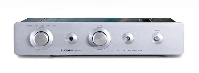

Nah!. I think that has 30wpc
No,some sites say 23 watt sugden say 25 watt
