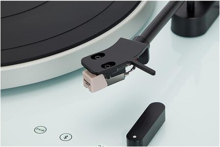

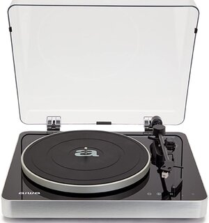

This Aiwa record player was bought new from Amazon but the seller is no longer with Amazon. I have had different types of record player's in the past but none where I had to set it up. It's working now with nice sound comes from LP albums. I always buy a spare stylus/needle but it seems not possible this time. This record player is for sale again with another company but this time with Amazon Prime that remark 'a stylus was given type number that goes with the impression to buy'. I purchased the same type/number and it did not fit (I paid only £10 from eBay). Can I change it with another Aiwa cartridge? I have contacted fx it Aiwa on-line but still to receive news about this
What does the handbook/manual say about replacing the stylus?
I’d be 99% sure the cartridge is an Audio Technica, with possibly some Aiwa branding. Aiwa don’t make cartridges and never have.
The whole cartridge can be swapped, but we’d need to be sure you have sufficient adjustment from the arm settings. (Some designs these days used a predetermined tracking pressure which eliminates the need for careful adjustment.)

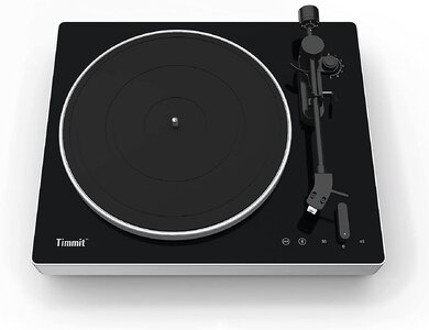

On Reddit, somebody says it’s a Chinese rebadged Timmit turntable, and adds that the headshell is not removable. That would discourage me from swapping the cartridge so let’s try to find out the replacement?
The manual only show the way to inset the stylus and stylus only has Aiwa Japan written on it.
I have found Timmit turntable website and it is the same turntable title Timmit. Now to find the stylus to buy.

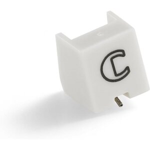

I found the stylus.
Crosley NP-15 Replacement Needle
