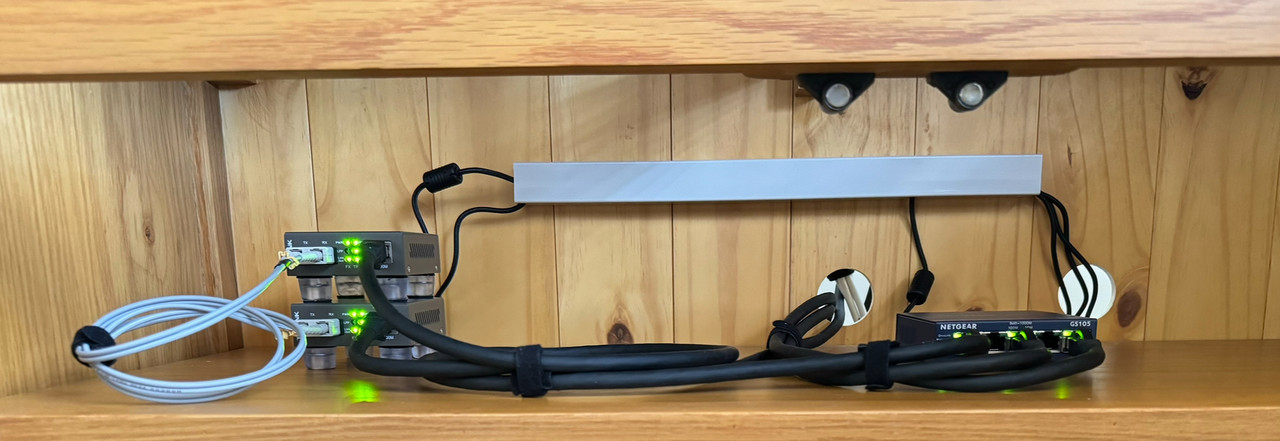

The iFI iPower2 SMPS power supplies arrived and have been installed to feed the two TP-Link MC100CM Media Converters. I must admit that the quality of the iFI SMPS power supplies is very nice, the surface finish and the braiding being particularly good. The packaging is also up there with some of the top mobile phones and using five of them now to replace stock SMPS power supplies. Can’t categorically state that there is a night and day difference, but for me, the system does sound very good, playing Jazz. Plus they look and feel nicer than the stock SMPS power supplies, even though most of them are hidden.
Have also changed the Multimode Duplex SC - SC Fibre Patch Lead, it was initially an OM2 spec with Orange sheathing, the new one is an OM1 spec with Grey sheathing.
Not being that familiar with fibre patch lead specs, I’m told that “OM1 has a core size of 62.5 um and is capable of distances up to 300 metres while OM2 has a core size of 50um and can travel up to 600 metres. However OM1 is commonly used for 100Mbps applications whilst OM2 is generally used for 1000Mbps applications”. Given that the Media Converter is 100Mbs and the cable length is only one metre, I’m assuming that the OM1 spec will be fine.
Also took the opportunity to put some trunking in to totally tidy up the power cables, trying to keep the power and data cables separate.

Back to the Media Converter (MC). By putting a physical break in the Ethernet cable stops noise affecting the analogue signal on the Ethernet cable. Using the MC creates this break by using a fibre Ethernet cable.
If you do a search for ADOT, this will give you all the information about this and you can buy the individual components much cheaper. However, it will not remedy a broadband issue.

Made some changes over Christmas.
Removed the NetGear GS105 gigabit switch and associated iFI SMPS. Now plug the Ethernet cable directly to the TP-Link MC100CM media converters.
This not only removed potentially two pieces of kit, but also reduced the electro/mechanical connections by two.
Now to have a listen and if there are any changes to the SQ.
