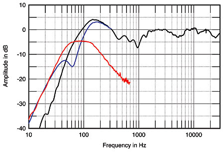

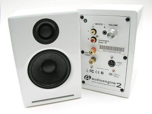

Audioengine a2
taken from http://www.stereophile.com/content/audioengine-2-powered-loudspeaker-measurements
Fig.5 Audioengine2, anechoic response on tweeter axis at 50", averaged across 30° horizontal
window and corrected for microphone response, with the nearfield responses of the port (red) and
woofer (blue) plotted below 700 and 300Hz, respectively, and the complex sum of the nearfield
responses plotted below 300Hz (black).

Now, my question is, do the subwoofer and speakers work together?
Can I hook my laptop through my audio interface to the subwoofer RCA connectors and the hook the
RCA connectors of the subwoofer to the Audioengine a2?
Then , can you explain to me how I'd go about to find the right crossover and phase setting on the
subwoofer?
