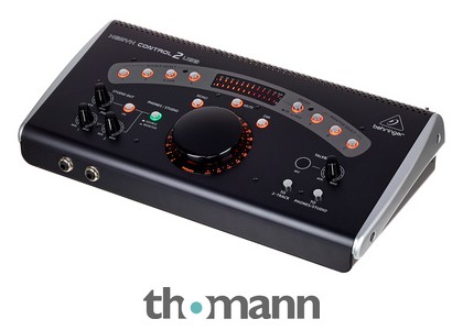

I've got nothing against Rega Jash (I worked there once) but I've got a suggestion for something more suitable for your purposes.
I can confirm it's OK, as I bought one for myself.
It's is a phono preamp / computer interface / headphone amp.
Have a look down bottom left on this page here:
You can download a PDF of the user manual. On page 7 is a block diagram, which shows the signal route and what it can do.
From the diagram you might notice that the one thing it doesn't do is put the computer out through the 'line out' RCA sockets (just allows computer on headphones).
But by taking a feed out of the headphone socket (with its gain set to 7.5) using the appropriate lead / adaptors.....it would do everything for you:
Without unplugging anything you could play PC, phono (or both) out to your speakers.
I think you may have heard of Bax music. I've used them quite a bit. Here it is, currently £76. Enter code LYT2066UWJS at the checkout to see if the 10% discount code works for you....making it £68.40 😍
