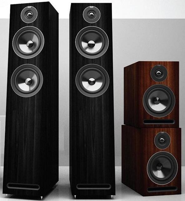

Here's a more typical example of a slotted port enclosure.
Here are some hifi speakers with slotted ports (Acoustic Energy 101).
