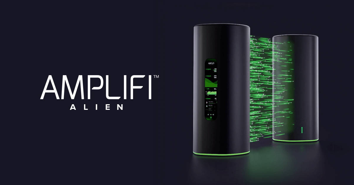

Networking is not a strong point of mine at all. But I asked a buddy who suggested you should look into Amplifi and the Alien in particular if you want Wi-Fi 6. You can also use the Amplifi HD as a cheaper option but there's no Wi-Fi 6.
Amplifi is the consumer brand for Ubiquiti. The Amplifi HD is solid, and comes with a main router/AP and two mesh APs. The Alien is brand new, much more expensive, and has WiFi 6. As of right now, you have to buy multiple Alien's to make a mesh network.

That Alien sure is nice. Doesn't look like it's available anywhere in Europe yet though.

He recommends the AmpliFi HD unless you just need the crazy bandwidth of WI-Fi 6. He thinks it's probably the most stable solution for you with all those IoT devices.
