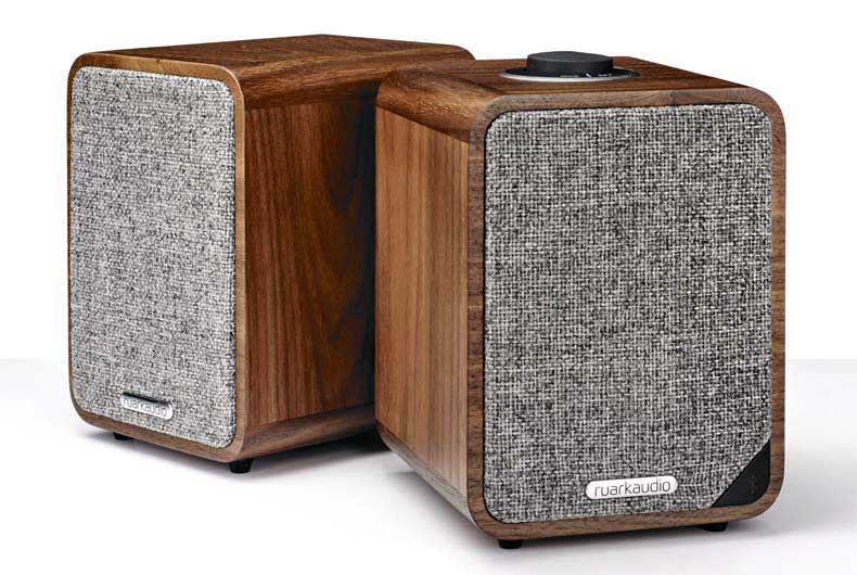

Or, better still, if £350 isn't too much:
