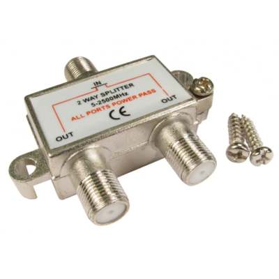

This is a passive type:
Aerial in, out to TV and Humax.
No need for Humax to be powered at all for TV to get its signal.
