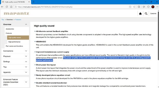

Is it possible I could use them with my Marantz PM7000n amp at 60 watts plus. If not are there any other sealed box speakers (new or old) that would play nice with the Marantz?

The current capacity of the NAIT 50 is 15A though which helps….. what’s the current capability of the Marantz ? A quick search suggests it’ll be fine in a near field environment not pushing the SCM7.
The speakers however will scale significantly with a better amp in the future.

Although ATC speakers will perform better with some decent power there is no reason to believe the SCM7 cannot be driven by your Marantz especially if not requiring disc levels of volume.
