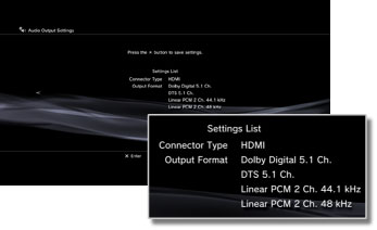

1. Go into Sound Settings, then Audio Output Settings, select HDMI, then select Manual. Leave Dolby Digital 5.1 Ch and DTS 5.1 Ch ticked and then scroll down the list and untick all the Linear PCM options which aren't greyed out. You'll find as you untick one, other Linear PCM options above become available to untick so untick them as they become available. Eventually, you should be left with only four ticked at the top, the Dolby Digital and DTS settings and two Linear PCM 2 Ch. settings which you can't untick as they are greyed out. If you scroll right to see the confirmation list, it should look like this:
Confirm this and now, since the PS3 doesn't think it can output Linear PCM, it will send Dolby Digital or DTS natively over the HDMI for everything. Of course the big issue with this is if you use your PS3 for Blu-Rays since the PS3 can no longer convert to PCM, so you won't get HD audio, just the regular Dolby Digital / DTS core tracks. This means using this option, you'd have to constantly turn these settings off and on.
