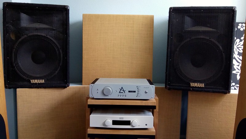

I won the auction and waiting to arrange collection. They're nothing special but just want to see how they work in home environment and how they respond to DSP.
Most importantly they're £40! Not really a risk, is it?
They're pub type Yamaha S15e...

I'm running them on the end of Hegel at the minute. They sound very dynamic. And they go very loud with little power. Bass is definitely not an issue and I'd even go as far as saying they don't have much of it. Great drums, lovely projected vocals and overal very enjoyable. They are setup narrow but I've got good distance to them so I'm happy about that. They do feel a little shouty at times so time for measuremnts and some DSP.
For anyone looking at budget gear, I don't see £40 better spent.
They're a very interesting pair of speakers. Mid forward and even thoug big woofers bass isn't neither big or great. It actually rolls of at 50Hz so I'm missing the first octave. I mean it's not like I could go down to 20Hz in my room but 30ish is very doable. Top is also rolled off. My ears took some beating but it was worth it 🙂
Mids are very forward as stock 2-3kHz in particular that give it aggressive voicing. Bass is lean in general which gives them a punchy sound. I generally like bite but with huge dynamics and easily going too loud I had to tame 2-3kHz region.
So far the best DSP I've got them to is more or less flat 50-3,000Hz and rolling off from there at 1dB per octave.

I suppose this is one way to learn that efficiency and bass extension are trade offs, one with the other! Now you’ll be able to use a 3watt tube amp!
And of course, enclosure volume.
Consider a horn loaded 15 inch driver, for a cut off frequency in the range 50-60hz, the horn needs to be about 12-15 ft long with a diameter around 12 ft. Picture this, it is actually quite large.
For practical applications, the horn is usually folded and designed to make use of room boundaries, for real world applications look at the Tannoy GRF enclosures or the Klipschhorn, both designed for corner mounting. When mounted away from from a room corner we end up with the classic JBL 4320 or Vitavox Thunderbolt enclosures which are actually useable, check out the big Living Voice systems as examples of Thunderbolt systems in use.
These are still pretty big enclosures, typically 16-20 cubic ft, and remember, this is the bass enclosure only! Back in the '60s and '70s, JBL optimised its best 15 inch drivers for reflex loading, into 9 cubic foot enclosures, typically 3 ft tall, 2 ft wide and 1.5 ft deep, the basis for the 4320 and 4330 series studio monitors and the hi-fi equivilents, the various L200 and L300 models.
As far as I know, the L200/300 models were, until quite recently, one of the last 'bin and horn' models build for the hi-fi market by a major manufacturer, the revival of the Klipsch Heresey/Cornwall models in recent times being one of the few exceptions I can think of.
As far as the Yamaha system is concerned, it would benefit greatly from a larger bass enclosure but that will involve a lot of work, interesting project though.
I knew vintage Tannoys also benefit from larger boxes. Didn't realise Yamahas would too. Not far from me there's a guy who builds guitar and bass amp cabinets. It wouldn't be out of question to do something like this. Probably not with these as quality of drive units isn't great (not complaining just being realistic) but maybe something better could be sourced.
