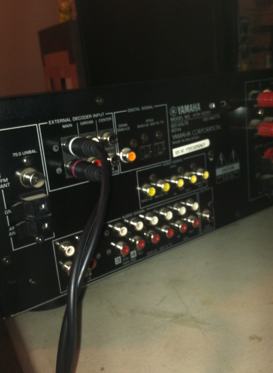

Here is my input that is coming from my Phone/Computer

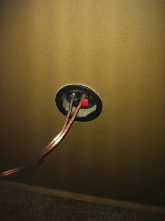

Here is my speaker wires in the back of my speakers.

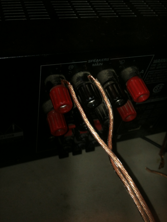

Here is my Speaker wire coming from my A port on the receiver to the speakers.

Super basic setup... I have tested with new receiver, speaker wire, and input wire from my phone/computer. I mean it pretty much has to be the speakers... right? But why would they both suddenly do this at the EXACT same time wat such a low volume...? it has to be something...
While it dosnt explain your sudden loss of high end, is there a reason you are using the 'external decoder input'? I don't know what the Yamaha's innards do with this input, but this would be the place to connect an external 5.1 source. The normal place to connect a stereo source such as your phone or PC would be 'aux' or 'cd'.
Can I assume the photo showing the speaker wiring at rear of amp is just an example and you actually have the left-hand speakers wire up this way as well in normal use.
